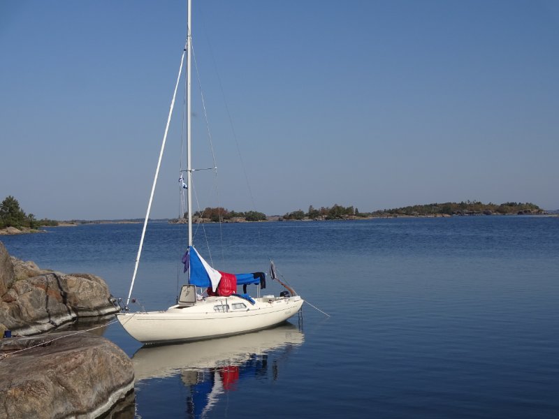

We sail in different waters and therefore both the size of anchor and the way we use it differs quite a bit. Whereas Johan sails in areas where almost the only option is to moor in a marina or guest harbor, I do most of my sailing in the Swedish archipelago on the east coast. Here we mostly stay over night by mooring to an island like you can see in the picture below.
For this to work I need an anchor, but nothing as heavy as the ones you use Zag. I have a 5 kg Bruce and no chain but only the anchor line and this has never failed me even though the weather not always is like on the picture.
Since my anchor in these cases is used in the stern I keep it in the large locker aft of the cockpit. But I realize that with heavier equipment this is not a viable solution.
In the few cases that I anchor without mooring to an island I simply bring it to the bow with the anchor line outside the shrouds. As you can imagine with such light weight equipment this is not very difficult.
