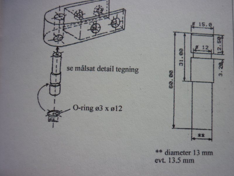

There are not many drawings of details about the rudder except these;
Re: drawing hings
The drawing displayed here is the only drawing of the kind that I have ever seen. It was published the first time in the Danish IF-boat magazine "IF-bladet" a couple of decades ago. The author was late Henrik Blomdahl, the former owner of "Muffe".

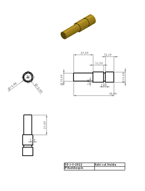

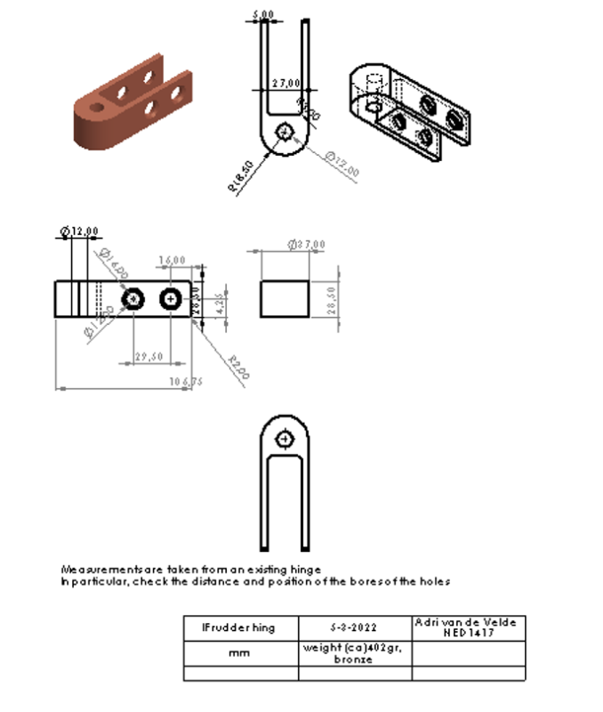

Just made a few drawings from it

Great!
Would it be possible for you to zoom in on the hinge and the pintle parts? It is hard to read the measurements. Or can you make a pdf-file of the drawings?

Re: drawing hings
This original sketching are from Medvind nr 2- 2010.
L Å Andersson

You are quite right L-Å!
I just measured three old ones I have saved. The diameter is larger than 12,00 mm. It varies between 13,10 and 13,30 mm on those three, measured with a caliper.
Perhaps there are variants. Check for a press fit in the hinge part hole before making the pins!

Inlägg av NED1417 »
I made the drawing by measuring old ones so there will probably be a difference in the sizes.
So be careful when you replace this part
