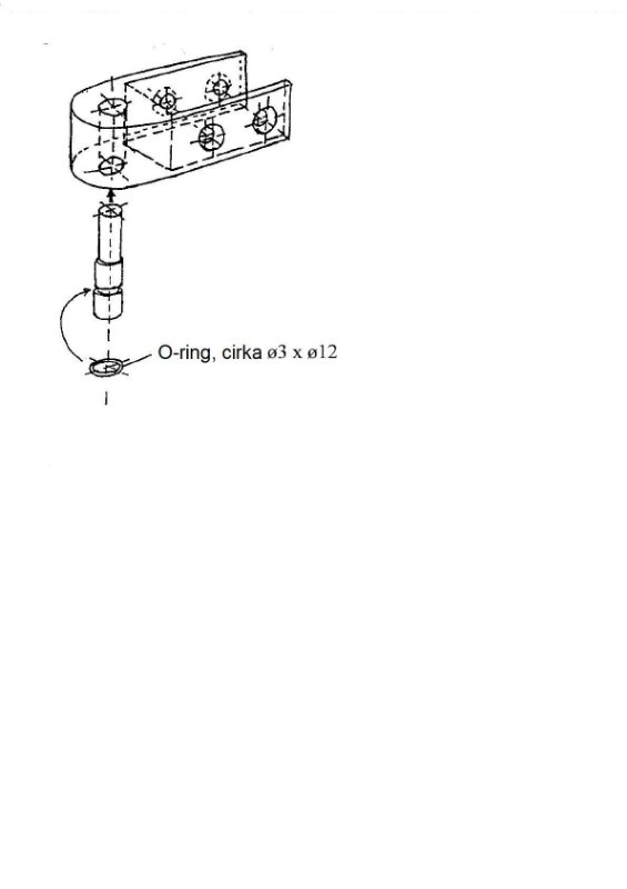

There is no detectable play in my rudder as far as the pintle O-rings are intact.
So, probably one or more of the O-rings on the rudder pintles have been worn to damage and are missing.
You have to lift off the rudder from the gudgeons and repalce the O-rings.
This actions should be done regulailry.
Personally, I lift off my rudder before every sailing season and repalce the O-rings as a preventive maintanence.
Ask for help from another person when lifting. Otherwise it is a great risk for the rudder to slip away from your hands and be seriously damaged.
On the attachements you may see how the O-ring is mounted on the pintle and how the "rudder stop peace" is mounded to the rudder under the pintle. Those "rudder stop peaces" are normally fixed to the rudder by a scew and have to be removed before lifting the ruddder.

These O-rings are simple ones from rubber. Sealing rings of a 1/2 inch hose garden watering hose system will do.
